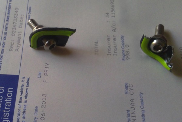

Went for a ride yesterday and my mate pulled me over and told me my plate had come off down the road,I laughed untill he pulled it out of his jacket... I had a look at the back of my bike and had only these two screws attached :shock:
went into the RTA today and they said yes it's a known problem,they noitified the plate mob and issued me a new plate free of charge then told me i may want to put rubber washers on to stop it happening again :shock:
what,are they made with chinese metal now.
Heads up people.

They tell you this after the fact but they don't recommend tightening them up to far (hmm) and using a rubber washer to lessen vibrations.

Happened to me about 3 years ago coming back from the Oxley. It was a standard number plate. I now secure with cable ties (wish I have invented them) and no issues since

dad's custom plate i got made up for him broke as well... tho that could be the guzzi and the v-twin vibes :lol: but yes, outsourcing to china isnt alway the genius idea people think it is

Nothing to do with Chinese built, plates are made from Aluminium, this stuff does not like the vibrations present at the mudguard! Have you ever looked at another bike sitting next to you at the lights, and noticed how much these things vibrate? Because manufacturers are trying to lose weight, the rear guard is now made from tissue paper, hence the vibrations! Plates are now made thinner also.

If your running a fender eliminator and have a rego tube at the bottom of your plate, they are more prone to breaking; had it happen twice, relocated the rego tube problem solved.
