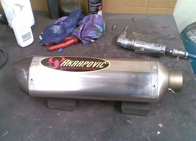

Now I knew the standard Akrapovic can was going to be way too long for my model ZX10, (over 520mm in length) so I have cut it down to a more reasonable length that is aesthetically pleasing to look at, (cut off 120mm to make it a totla length of 400mm) but also is an extra 100mm longer than the shorter Yoshi can.. it has come up a treat.. (this is not the first time I have cut down a muffler though) The titanium sleeve and carbon tip look hot.. I cant wait to fit it up for the test.. So here are the 'cutting up - shortening - rebuilding' pics for you. If you have never cut down a muffler before, dont be scared, it is quite easy, a bit fiddly with the re-packing, but with the right tools it will go back together just like a new one...
Pics of it fitted to the bike will come later.. I just have to make up a small adaptor sleeve to go inside the Akrapovic inlet to make it a tiny bit smaller so it will fit perfectly to the Yoshi mid pipe... So it will be a complete mix of Kawasaki Headers into Yoshi Mid Pipe into Akrapovic Titanium can... :shock: Yeah a real mix up, but it's going to look and sound awesome, I can tell already.. ;) I also have the carbon 'M4' pipe I have as a spare, but I might sell that one to a lucky KSRC Forum member.. ;)
Macca :kuda:
Front section, rear 120mm cut off...

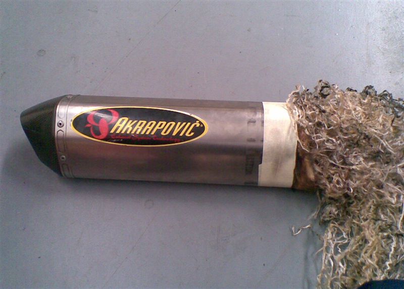

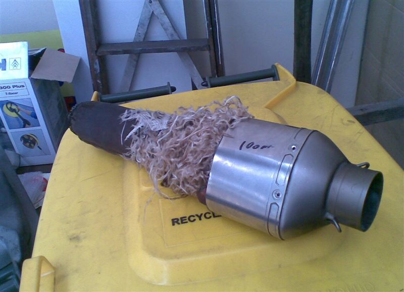

Rear section with heaps of packing hanging out...

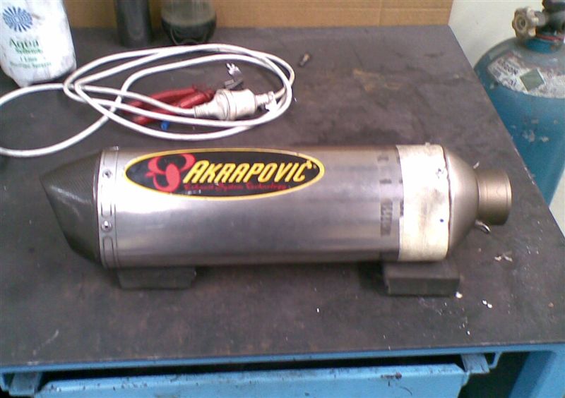

All re-packed and back together ready for pop riveting...
The finished product, like a new one, just needs a little more polishing...
