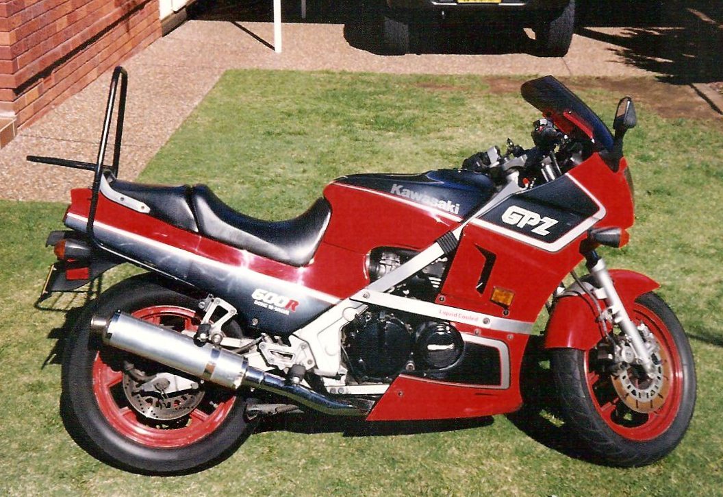

A pic for inspiration
GPZ600R 001.jpg (230.71 KiB) Viewed 9265 times

smithy5 wrote:......Nice pick up Gos, aaaaaaaahhhhhhhhh the memories........A pic for inspiration
nice pic mate !! In that photo - its easy enough to picture the big DC motor replacing the clutch/transmission section. The basic diameter of the clutch cover and the DC motor is roughly the same. Everything else - will be batteries. But the standard fairings and seat/ducktail etc do not change at all. At a glance - it will look identical to any other GPz600R - except for the lack of an exhaust system......
