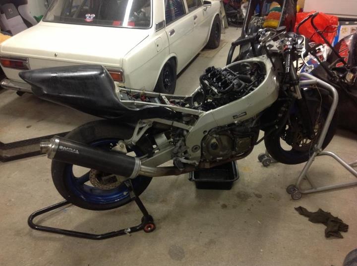

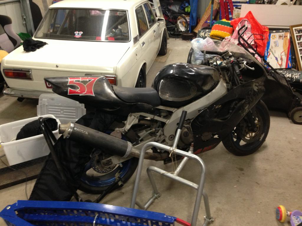

As picked up, already stripped into buckets of bits hoefully to be put back together over the next month or two a lot greener and shinier.
- Dusty arrival after about 5 years in storage
- ZX9Rb.JPG (142.1 KiB) Viewed 13990 times
- Tank off for a quick clean up and got it running to make sure mechanically ok.
- ZX9Ra.JPG (103.84 KiB) Viewed 13990 times

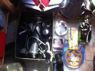

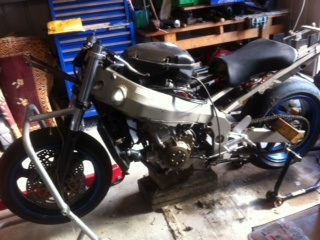

Got some ram ducts thanks to Kwak Addict. So parts are all there got some new go faster bits give old bit a clean and paint where it needs and ready to put back together. Currently waiting for 6 point socket to attempt front sprocket change and some big Allen keys for front axle So I can get to the head stem to change the bearings.
- Mmmmmm ZX9R pieces
- image.jpg (34.14 KiB) Viewed 13916 times
- The beast
- image.jpg (40.27 KiB) Viewed 13916 times
