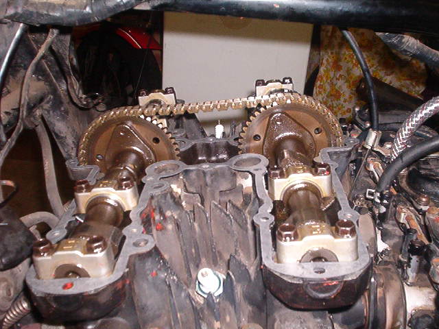

Just when you think everything is ok...........
When I put the cam cover back on the cover is pivoting off the centre.
The cam chain guide is hitting the cam chain by quite a bit causing the cover to rock.
It was an old gasket which was fairly compressed but now i've taken it off again and cleaned it up there is about 4 or 5mm difference and I don't think the new gasket will take that much up so the cam chain will run along the guide to the point that it will chew it out and spread through the engine. As if it will need 2 gaskets to clear.
Doesn't make sense. anyone seen this before?
Re: GPZ750 Cam chain adjuster
Are you running the cam chain under the center roller or on the top? It's meant to run underneath.
This model doesn't have the centre roller of the Z650.
Cam chain is heavier too. I think they called these a hyvo chain or something.
Yeah but there's a guide there and the diagram I'm looking at shows it above the chain still.
I haven't seen the top end of one in person though so can't say for sure.
Guide inside cam cover is interfering with the cam chain.
Cam cover is straight. Guide looks in good condition.
