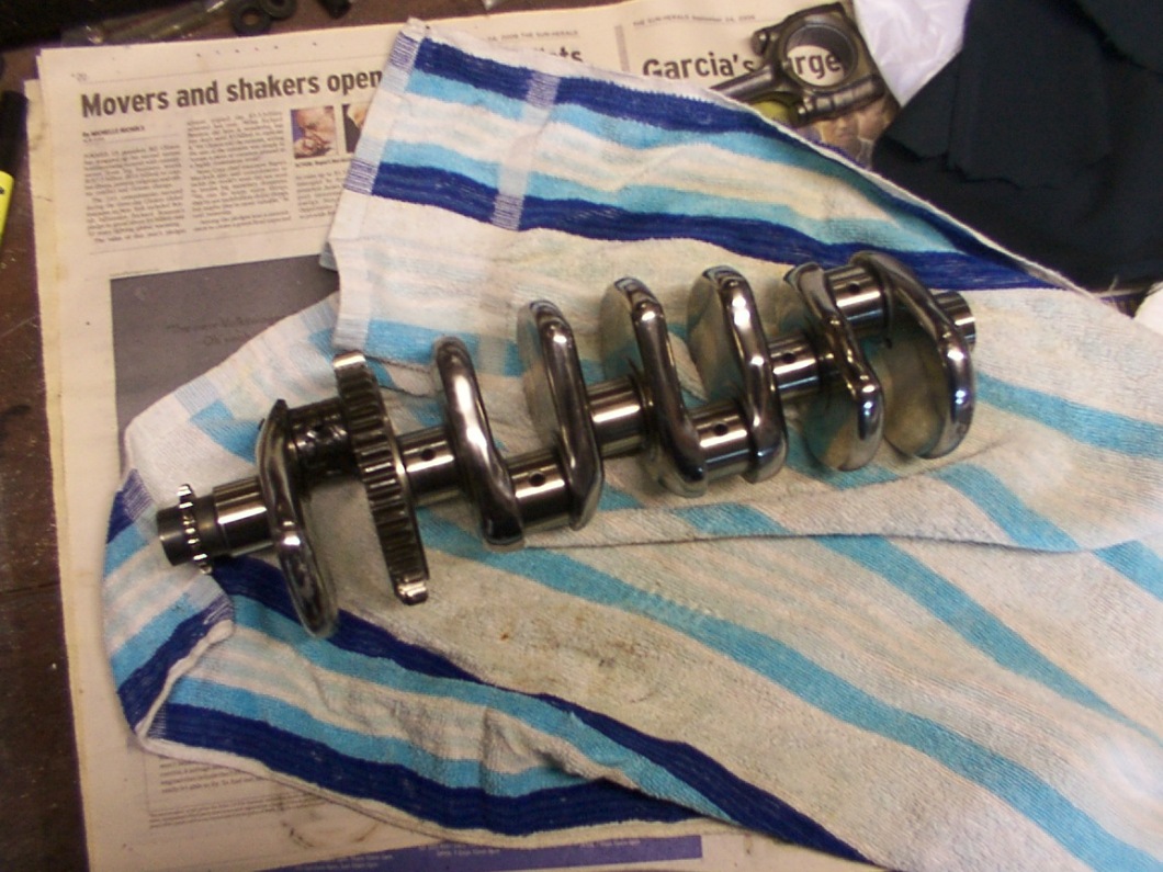

I have 1 1/2 engines, but not sure what I'm looking at - is the crank and the rods anything special? The loose rods are different and look stock to me. I have one Hallam head and what looks like a reco stocker.

Re: ZXR 750 M frame and engine nos
Not sure about the rods, don't remember if the kit rods had different ID numbers - they're 5mm longer than stock, if you have any others for comparison. Cases are clearly modified early ones. I - think - the crank may have be lightened, but to be honest it's a few years since I've looked at a standard one (attached is a pic of a factory crank that i have, from the WSB engine).
Bike looks nice, I have a feeling that Shaun Sutcliffe (ex-TKA) may have built it or owned it at one point (the ISRs and WPs (?) are a bit of a giveaway).

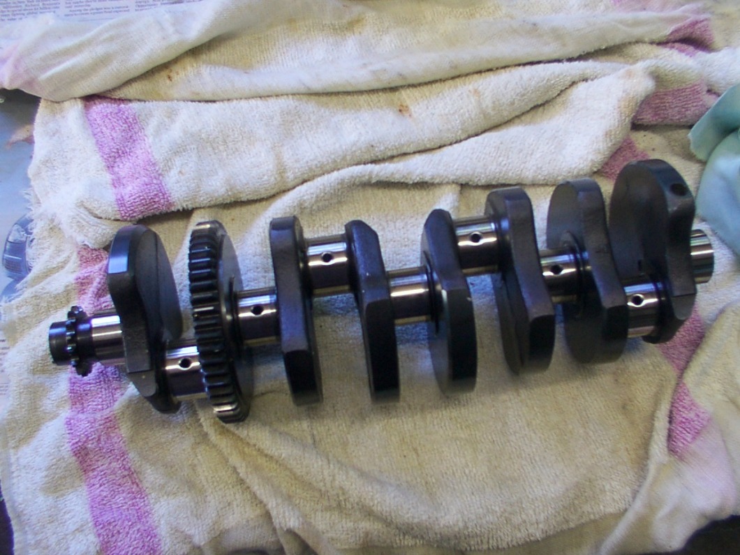

Was just having a nostalgic trip through my photos of the trick ZXR parts I used to have, and found this shot of a standard J-K-L-M crank - yours is definitely lightened, then.
Cheers,
Brian
