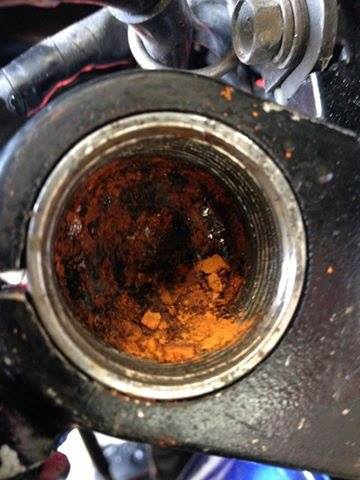

this is  what was found in side of both forks legs when i went have new seals fitted
bonester
Posts: 2075
Re: forks
Post by bonester »
that looks like just the caps rusting. forks might be ok. There is an o-ring to keep that crud out of the insides of the fork.

Post by wilbur42 »
that would be nice i have the bike in the shop the guy who doing the work told me there stuffed
h.b.bear
Posts: 1175
Location: Tamworth NSW
Re: forks
Post by h.b.bear »
Need to take it out of the shop and pull the forks off yourself if your that way inclined and then take them back to the shop to have inners replaced or let the guru forum members walk you through it. If they were mine I would find some one with a sand blaster just to give that a quick hit to rid all that rust which looks like it will come of easy, if your outside chrome isn't rusty and pitted job should be right and as Bonester states there is a o - ring there that will protect the inners. A lot of mechanics now days will tell u they are stuffed as they couldn't be bothered because it needs a bit of attention to remove a bolt or whatever

Re: forks
yeh that picture is a pretty common sight for most ZX1100 owners - the stock fork cap-covers are shithouse and let water in. Over time - it does rust really badly. There is probably nothing wrong with the inside of the forks though, as per Bonesters advice.
If the outer surface of the staunchions is still in good nick - it is worth trying to save those forks. What is hiding under that rust is a 1/2" drive socket hole. You need to soak the fuck out of that whole area with Penetrene or something similiar. Most mechanics would take one look at that mess and just run away - but let the Penetrene do the work and the fork cap should come out. If you round off the socket hole though......be prepared to lose the entire fork. If you round off the 1/2" drive fitting in the top cap - the only thing worth saving on the fork is the anti-dive unit - and even then only if the a/d unit is in good nick.
The set of forks I have in the shed which I was thinking about for you - have exactly the same problem. I have tried several times to get these fork caps off, but they just won't budge. I still fill the caps up with Penetrene though - eventually they will buckle and I am no hurry :lol:. These forks won't be much use to you as I thought your problem was with the chrome staunchions being pitted ?
You can still get these 1100 forks as parts from US ebay - pretty cheap too. Could be worth a look ?
