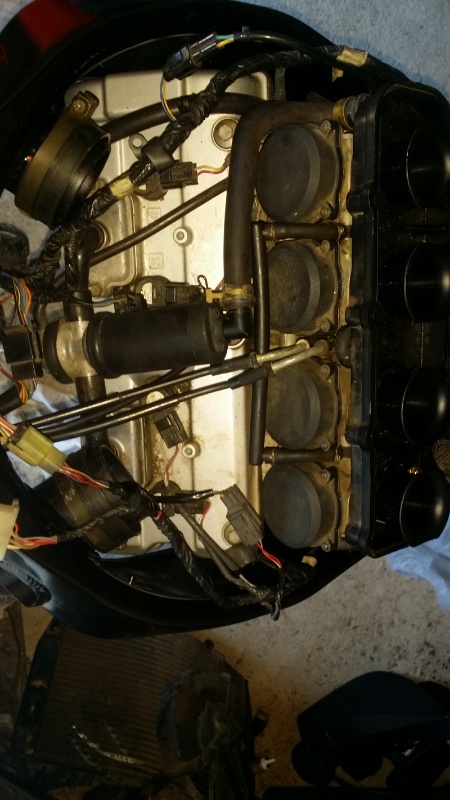

So I started stripping the bike down in May 2012. Long story short, it ended up at a mates place and I got it back in bits a few weeks ago.
I have a Haynes manual but it doesn't seem to help, so is everything in the picture in its correct place?
99 zx9r - back
QQQ
Posts: 37
Joined: Sun Nov 18, 2012 8:38 pm
Re: 99 zx9r - Does this look right?
Post by QQQ »
Nothing is standing out as completely out of place. As long as the airbox goes on without fouling I'd say ur good to go.
z3149441
Posts: 7
Joined: Sun May 25, 2014 7:21 pm
Post by z3149441 »
Looks ok from here, with the exception of the ram air tubes a little to far over the motor. I can PM you some pictures out of the Kawasaki manual if you think that may help?
Get rid of the KLEEN stuff.
paulsj
Posts: 224
Joined: Thu Jun 03, 2004 3:37 pm
Location: melbourne
Post by paulsj »
Does getting rid of the Kleen stuff do much? Been thinking about that for my one? You mean buying the blanking plates for top of the rocker covers and removing the plumbing??
Doesn't add any hp but reduces the backfire and popping on decel and makes it easier to tune air fuel ratios.
You don't need block off plates, just put a connector or a hose between the outlets in the plates in there and block the hole in the air box..
98ninja
Posts: 695
Location: Inverell
Post by 98ninja »
z3149441 wrote:Looks ok from here, with the exception of the ram air tubes a little to far over the motor. I can PM you some pictures out of the Kawasaki manual if you think that may help?
That'd be great thank you. I think I've got the tubes in backwards.
I'm off to bunnings to get some 16mm copper tubing to connect the kleen tunes together.

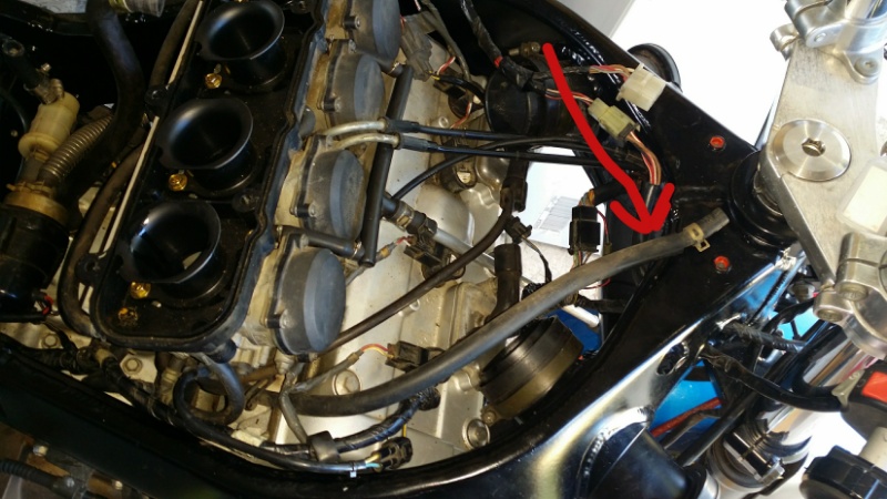

Also any idea where this house plugs into?
It connects at the back of the carburetors right I'm the middle
99 zx9r - back
shadowzx9
Posts: 266
Joined: Tue Jul 25, 2006 10:12 am
Location: Seederney
Post by shadowzx9 »
Back of the carbs?
might want to have a look, looks like the line from the Radiator to the back of the barrels
Grace - 2011 Ninja 1000SX
Isn't that the one that goes into air intakes in the front fairing.?
If so it pressurizes the float bowl
QQQ
Posts: 37
Post by QQQ »
Looks like the line to the radiator.
z3149441
Posts: 7
Post by z3149441 »
goes to the radiator. Think that its the one that connects just below the radiator cap.
Carb heater hoses I think from my drug fucked memory.......

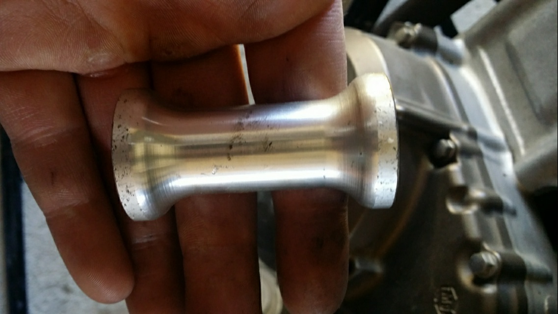

Ok next question. The thing in the photo. It's meant to go on the rear engine bolt above where the sprocket is. Does it serve a purpose? Because it's a caaaarnt to fit
99 zx9r - back
shadowzx9
Posts: 266
Location: Seederney
Post by shadowzx9 »
Its a spacer, you dont want to be leaving that off :D
