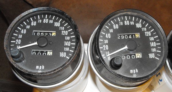

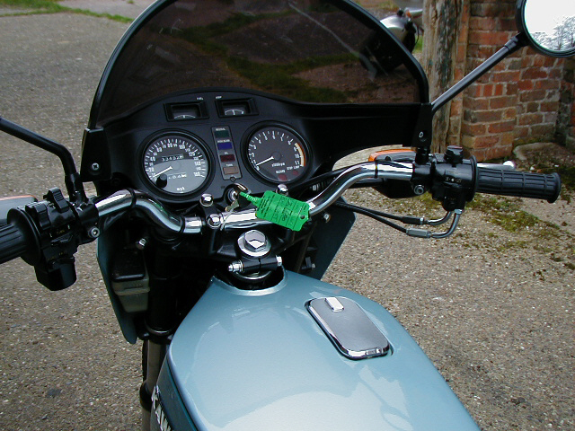

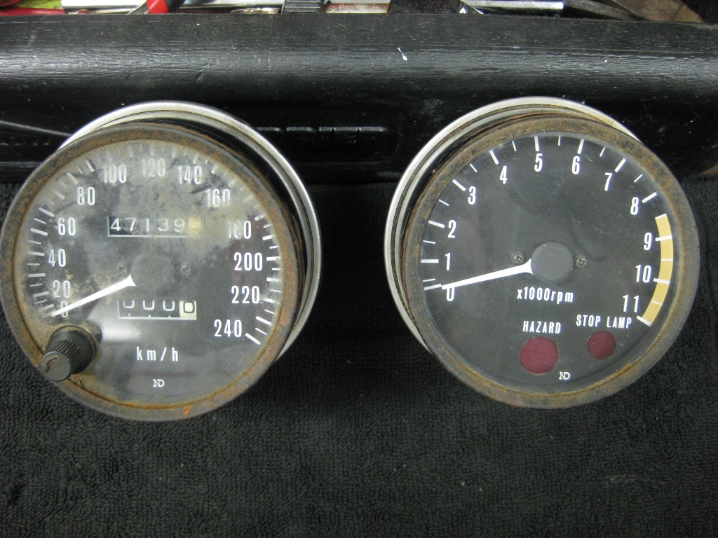

Need to pull the rev counter and speedo apart and refurbish. The Z1-R has the tripmeter knob on the face of the clock (shaft comes through the front of the glass - see attached pic) and I haven't been able to remove this - don't want to force it! Anyone had one of these apart and are there any tricks/traps/tips ? Ta, Slimey.

mate - unless you have the right gear, this is a job for the professionals - believe me. I will do just about any job on a Zed - but working on the gauges is not one of those things. Those re-set knobs are just a tight push on/pull off fit and the easiest job of all
the difficulties start with those steel retaining rings that hold the front and rear internal sections of the gauges together. These are specially pressed into place and cannot be removed and used again - you need the right gear to press a new ring over the 2 sections once the internals have been cleaned up. Its easy enough to remove the rear cover from the instruments - its just held on with 1 small screw......but getting to the gauge faces is where it gets difficult.
Lionel Otto is your man. He does these for a living and uses the right parts to re-build the instruments back to as-new, once the internals have been cleaned up.

The Z1-R has only the face of the clocks visible - see attached - the chrome edging strip is hidden under the fascia of the fairing so any marks aren't going to be a problem. Did you have any problems with removal of the needle and did you apply the new decal directly on top of the "old" face or did you strip and repaint the dial black before putting the new decal on?

The bike is not mine - just a pommy one to illustrate the clock setup in the fairing. I got the decals - actually transfers, not cardboard, from Repro Decals in the u/s of A for about $Oz 30-00 who also sell full decal warning sets for about $Oz 50-00. How much were the cardboard jobbies? - might be easier than friggin' around with transfers, stripping and repainting the faceplates!

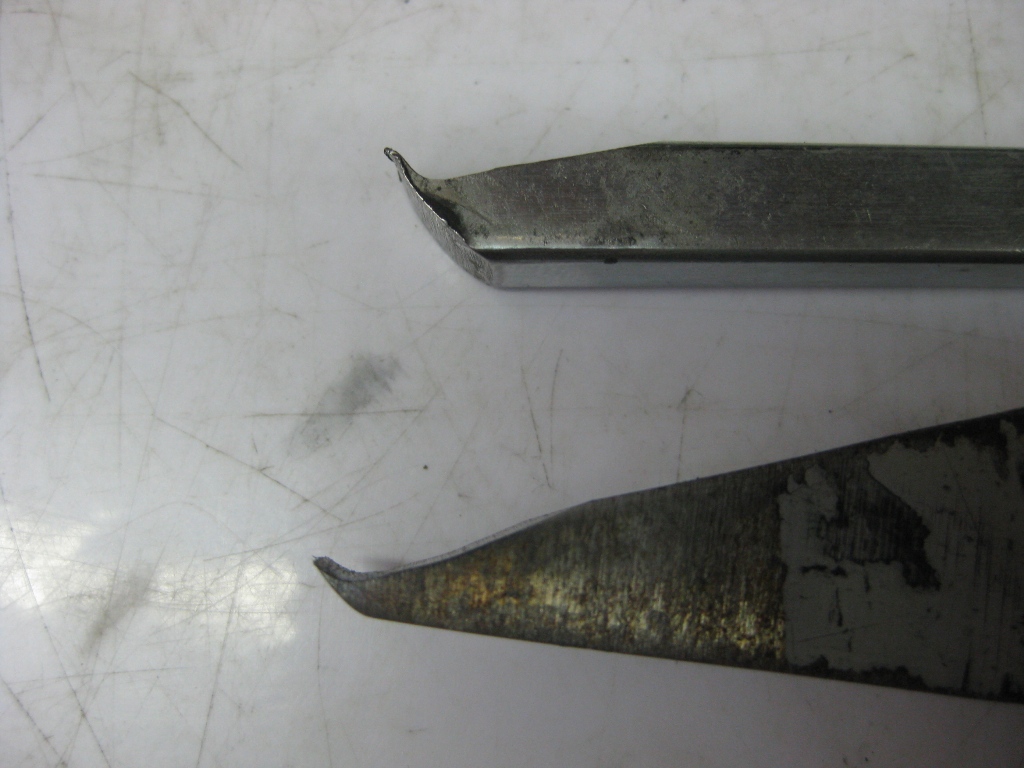

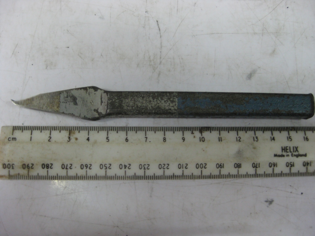

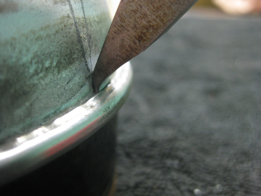

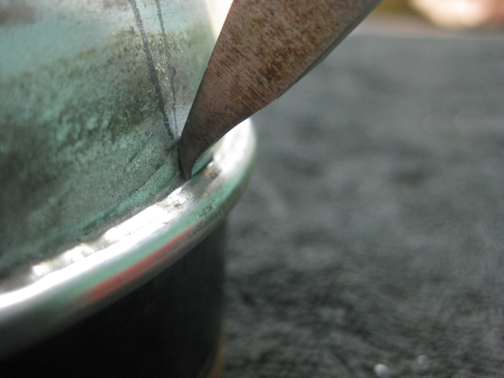

G'day Guys, some pics of clock restoration progress coming your way - will send 'em couple at a time with some words.
These first ones are of the tool I made to expand the clamping ring - version one was from a piece of mild steel - door shaft. This was too soft and bent when I applied it to the ring
. Need to use tool steel or similar as a sharp thin edge is needed to get under the ring to lift it. I made the final version out of an old chisel which had a 5 mm wide edge and did the job without twisting/bending

Re: Z1-R Clock Stripdown

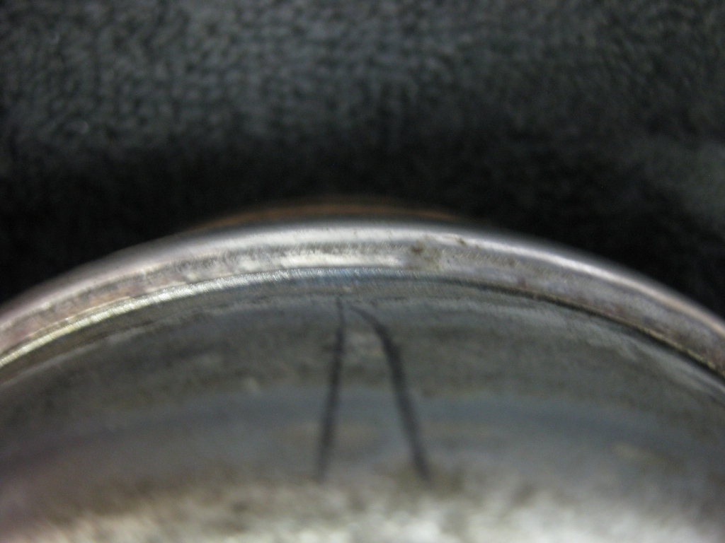

These pics show the clocks before disassembly and the position of the tool on the clock. Note the initial condition of the clamping rings, some distortion and marks evident - not sure if anyone has had a go at this already...? However, the Z1-R clocks only have the front face visible - the rest is covered by the fairing so it's not too critical - just need to be happy with the end product, unless a concourse resto is the aim.

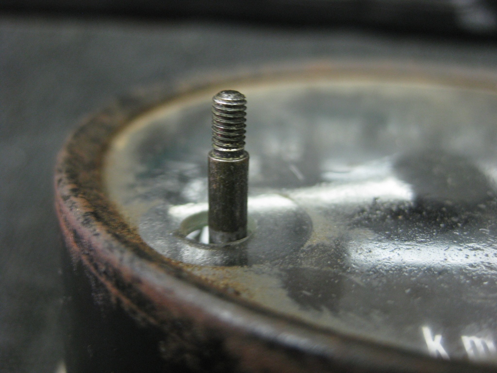

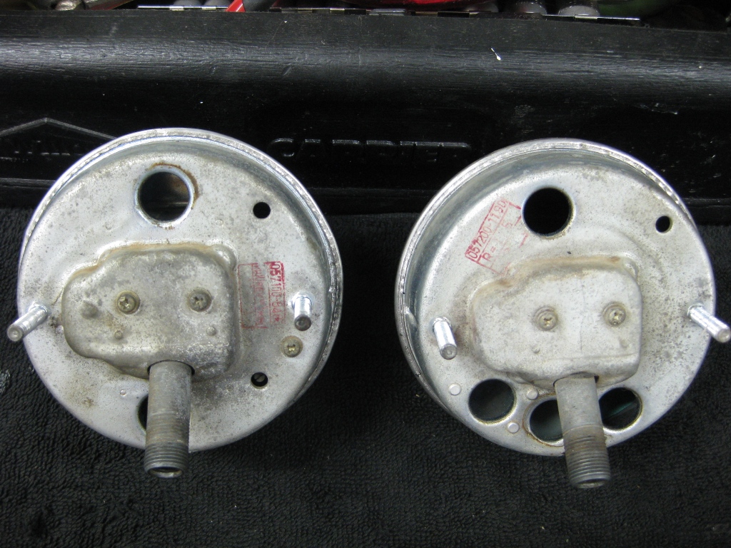

During the disassembly of the clocks I discovered that the trip meter reset knob is on a LH threaded shaft - see pic- so be careful not to bugger up the knob/shaft by pulling on the knob or trying to loosen the LH thread with too much force or it'll strip!

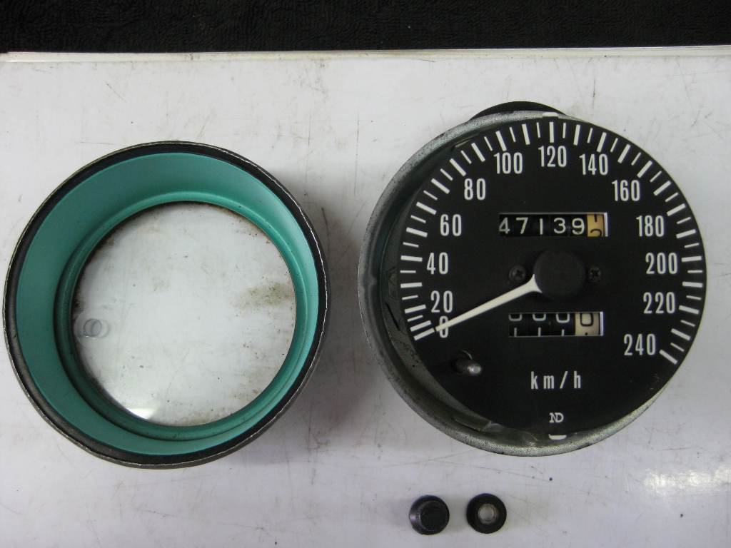

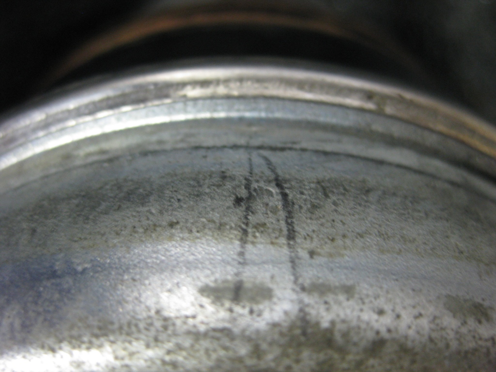

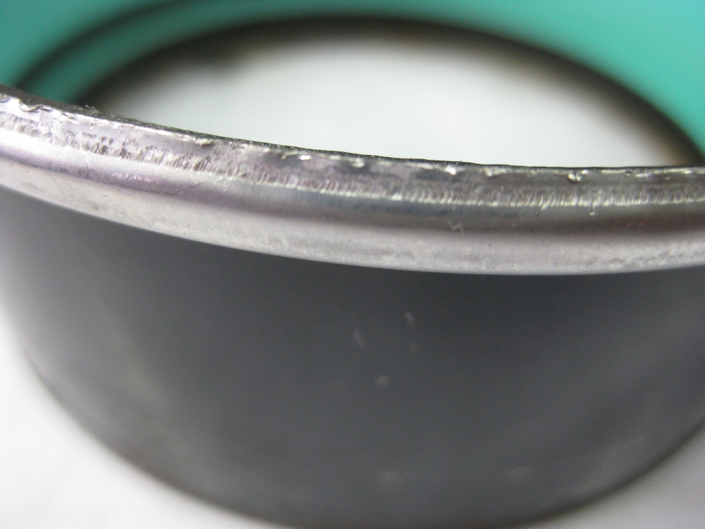

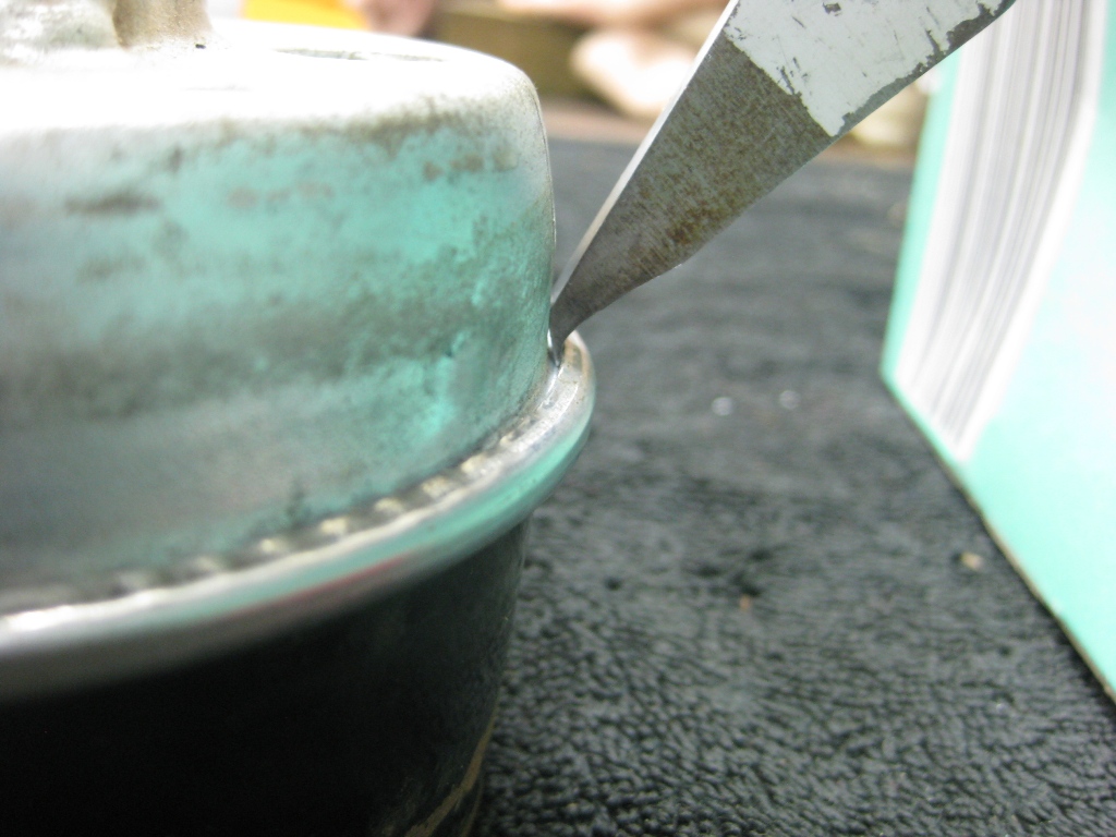

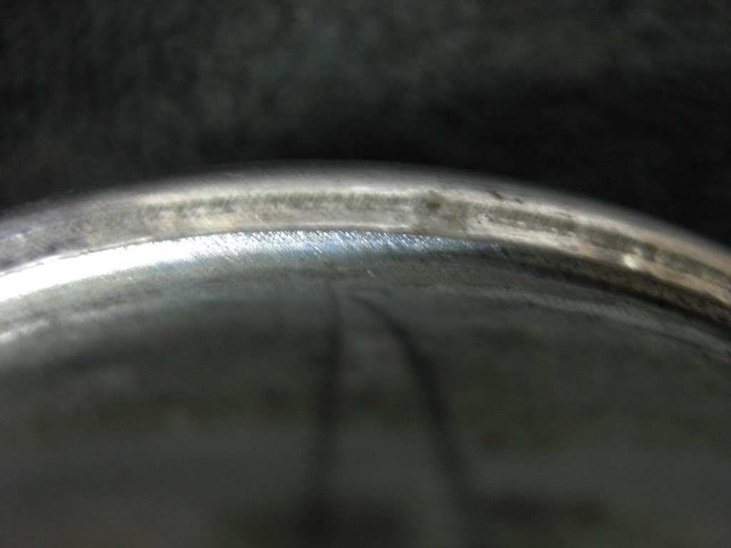

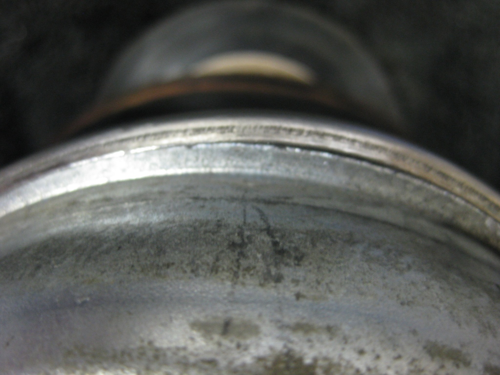

Now a few pics of the subject ring as it is gradually removed using the tool to lever it away from the body of the clock. Note that only the inner/lower side of the ring is expanded - this hides any marks from view if you're using this technique on a non-faired instrument.

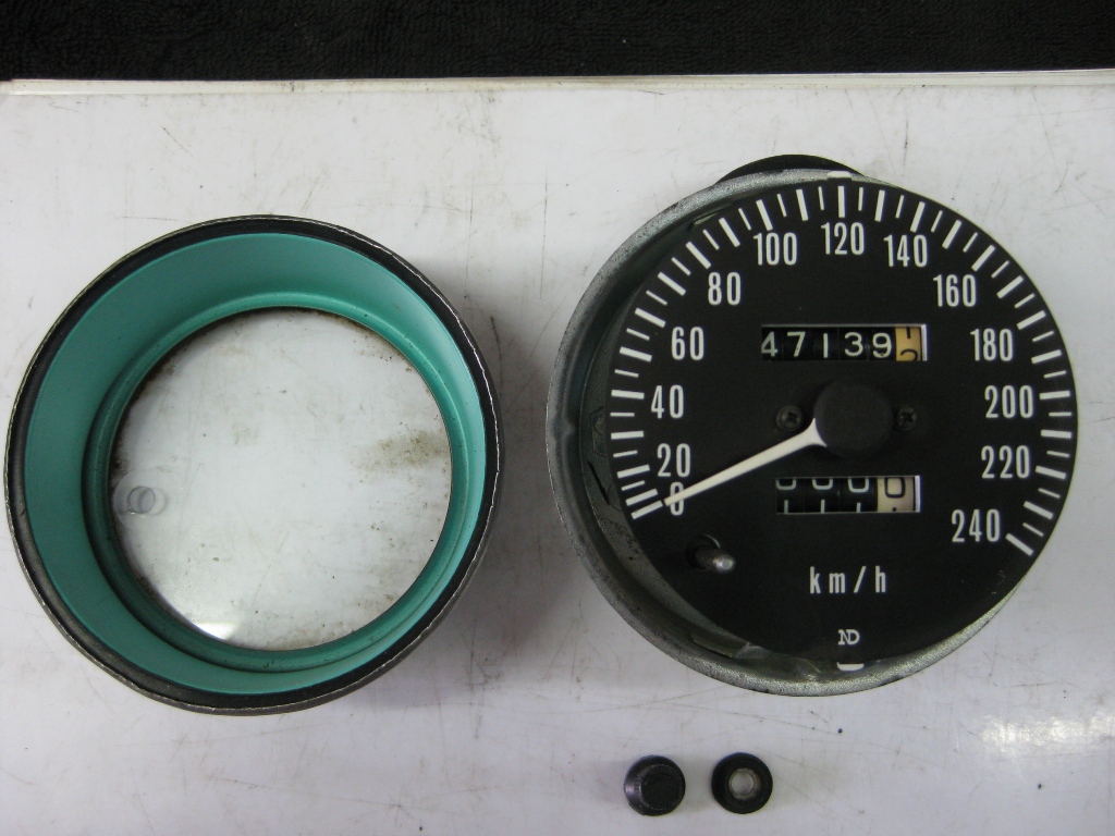

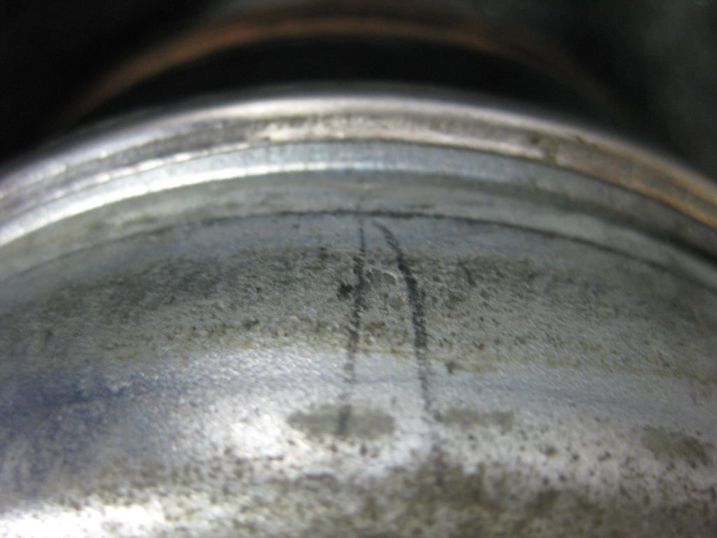

Couple more pics of the ring and separated speedo assembly.
