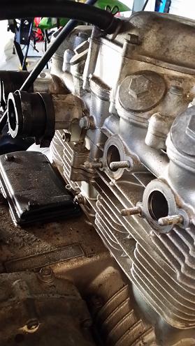

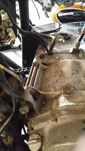

My question is, is there a way to get the surface corrosion off the engine without taking off each individual case?
Please see attached photo's for the corrosion

Re: Not a kwaka
if you have a air compressor you can make a soda blaster to clean it. If not sur check one out on you tube
pkay
- Posts: 158
- Joined: Thu Jan 30, 2014 1:13 pm
- Bike: ZXR750
- Location: Brizvegas
Re: Not a kwaka
If you try to soda blast that in situ you'll be pulling material out of everywhere forever, needless to say it will get into all sorts of places. It takes about and hour to pull the motor and they are light enough that you'll be able to lift it onto a trolley. I'd pull it clean it and then stick it back in. That caked on stuff is very hard to get off but you may find a high pressure washer will work. You'll need to blank off all the engine access points and also change the oil and filter once your done.
