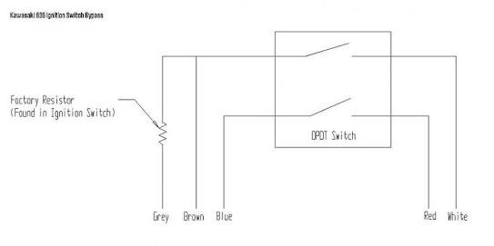

Something like this with a 100ohm half watt resistor

Paul is spot on, I had the same issue with my ZXR when converting it to a 'Race Loom'
The CDI unit needs to see a signal of around 0.7V (don't quote me on the exact figure) when the ignition key is turned so it knows the ignition circuit has been switched on with the key & not hotwired. If that signal doesn't happen, the CDI will not switch on the ignition circuit.
Plug the standard ignition barrel back in & it'll fire right up,

thanks heaps guys :kuda: - this now makes a lot more sense of the loose papers which were in the Clymer manual for this bike that Swabio gave me. There were 2 hand-drawn wiring diagrams, both of them mentioned a 100ohm resistor in the grey wire - I had NFI what this was about. Now I can see why this has been added.....
Rob - the bike came to me in parts only - the frame was sourced from Swabio (ex-Kevin Curtain spare) - engine and some bits from the ACT and a lot of the rest (bodywork and ancilleries) from another bloke in the ACT who is converting his ZX6 to an electric bike - one thing which was not included in any of the boxes - is an ignition barrel and key :lol:
OK off to Jaycar tomorrow for a 5W 100ohm ceramic resistor !! That should get things moving along nicely :kuda: :kuda:

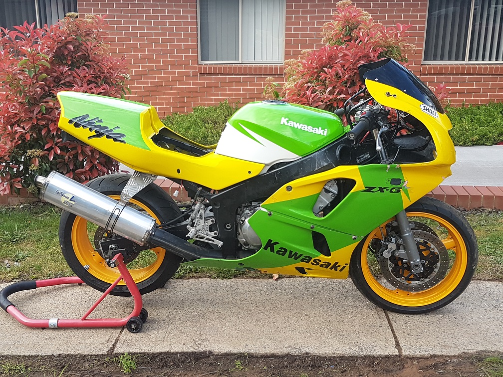

hell yeah it does :) me one happy boy. Finished a thorough carbie clean and set-up yesterday......the difference is what you would expect :kuda:
:kuda: :kuda:
Re: ZX6R F1 no spark
How it looks today :kuda:
