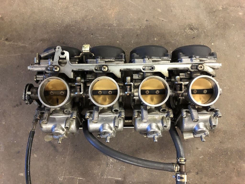

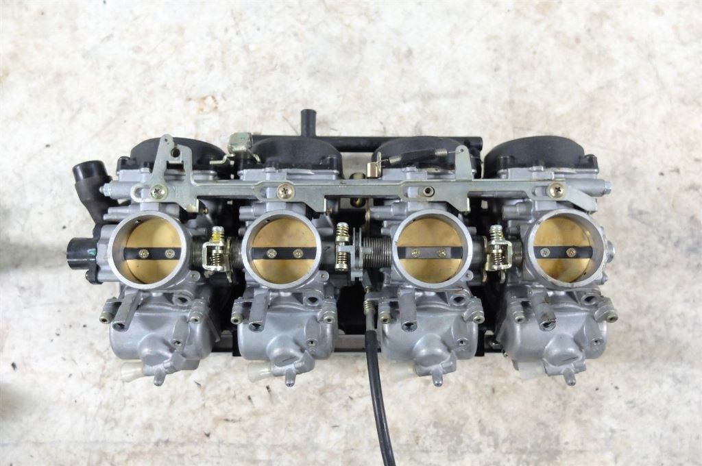

The C model carbs are spaced differently compared with the B model. The B model are equispaced whereas the C model aren't, wider between cylinders 2 & 3 compared to 1 & 2 and 3 & 4(see images below). The airbox fitment might be an issue too. They are essentially the same carb though, i.e. 40mm CVK, so unless you are willing to pull them apart and re-space them, re-route the throttle cables and modify the choke bracket, you might want to source a set off a B model, or better still get a set of FCR's which will really make your 950 sing. The ZX7 carb is smaller at 38mm, so will be too small.

- B model carbs
- b model carbs.jpg (159.31 KiB) Viewed 40318 times
- C model carbs
- c model carbs.jpg (94.91 KiB) Viewed 40318 times
