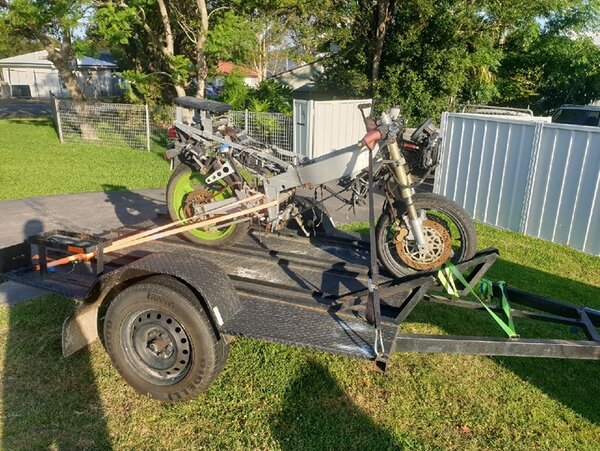

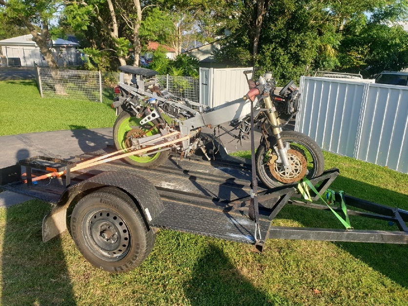

In December last year a 1990 zxr400 popped up for sale about 3km from me. I knew I had to have it. The bike came with an engine but was incomplete.
There was a number plate attached to the rear fender so I did a registration check on it.......... last registered in 1999......

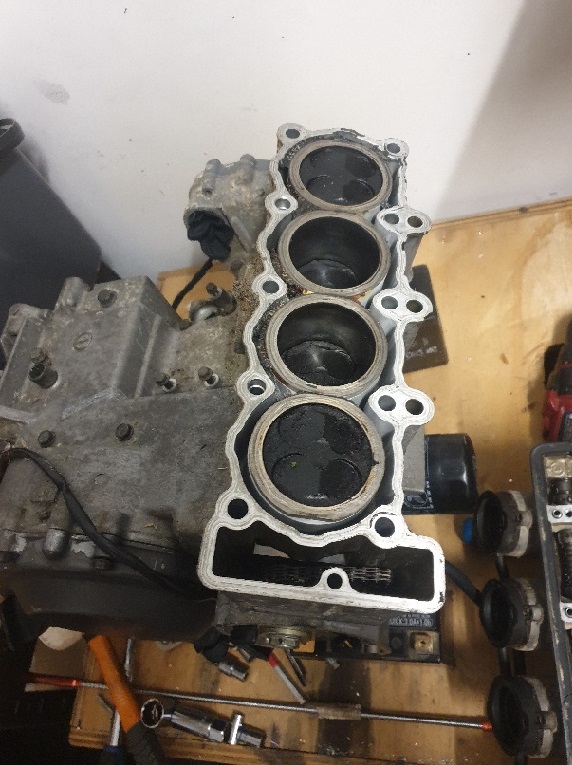

So my first challenge was to make sure the engine was ok before I proceeded into putting any effort into the rest of the bike. I searched the internet
and found that webike in Japan had OEM head gaskets and sump gaskets in stock. I ordered them and pulled the cylinder head off and sump off to inspect the inside
of the engine. To my surprise everything inside was immaculate and all turned over effortlessly. The valve clearances were out quite a bit so I fixed that up
with some shims from Precision Shims in Victoria.

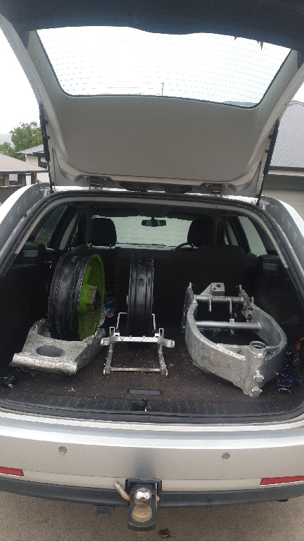

I started to strip the frame down. The frame and swingarm had some light corrosion as well as the fork stanchions. The frame, swingarm, wheels and rear subframe
were sent to a local powdercoaters where they were acid dipped and treated before they were powdercoated satin black. I bead blasted the fork stanchions and stripped

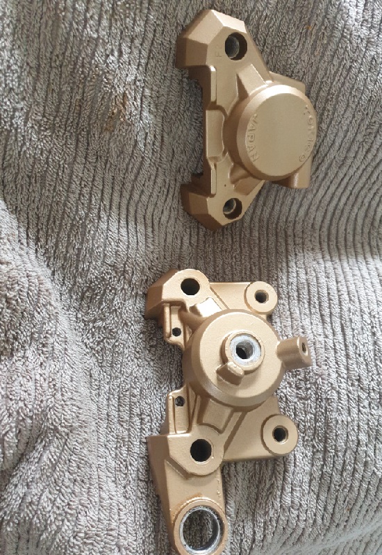

Both front and rear brakes were stripped down, bead blasted, rehoned, painted gold before being reassembled with all new OEM seals and bolts.

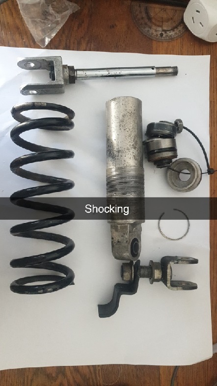

I pulled the rear shock apart and saw that the shock shaft is pitted. Ken Watson offered the advice that the shock is rebuildable but not with a pitted shaft. I couldnt find a replacement showa part and was a bit discouraged and was contemplating a shock off another bike. I asked a question on the Historic Racing Motorcycles for sale facebook group and was given many answers that the shaft can be made very easily. So the shaft is off now getting duplicated. The suspension linkage was cleaned thoroughly and regreased. I wanted a rolling bike and I found that a spare rgv250 vj21 shock that I had slotted straight in.

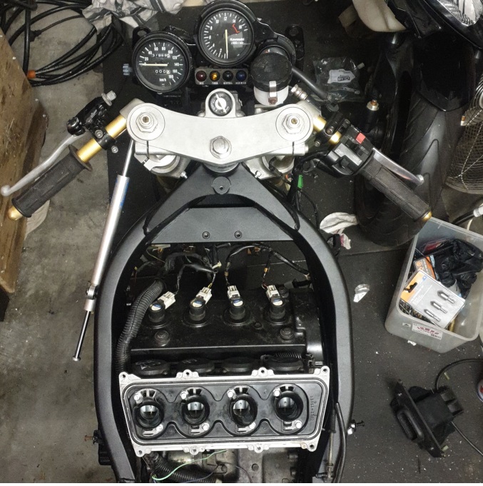

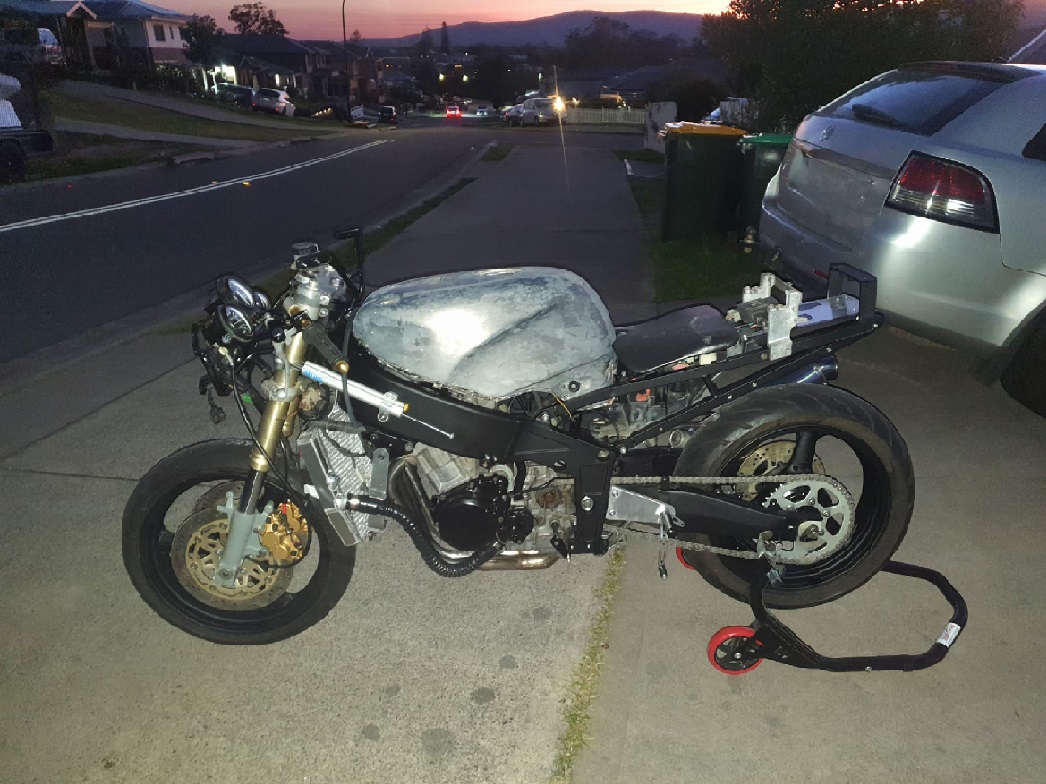

I assembled the bike to a rolling chassis and made an aluminium tray to utilise part of the original underseat battery holder and mount a new regulator rectifier and the ECU.
There is still a few parts to source such as raceglass, an exhaust system (Delkevic have new ones), chain and sprocket etc
The bike is now sitting assembled waiting on those parts.

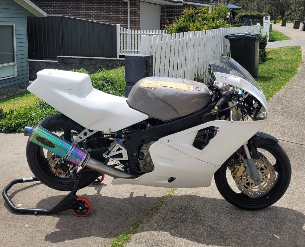

So I'm up to the point of filling it with oil and coolant, getting a battery and starting it and hoping my mechanic work
was good. The shock shaft has been made and returned. I have all of the components sitting in a box ready to send off to
Keo Watson for a rebuild and adjusting for my heft. I'm trying to source some race glass. H model race glass seems pretty scarce
whilst L model is plentiful.
I found a BEET exhaust on facebook marketplace for a zrx1200 or similar, drilled out the rivets and replaced the inner tube with one
that fit the Delkevic headers that I'd installed. I repacked the exhaust with new packing and riveted it all back together.
Custom rearsets to match the BEET dimension rearsets have been made. I bought TYGA gear shift pedals, brake pedals, and footpegs.
Braided lines front and rear fitted. Rear caliper put back together after all new seals. I made a cheap rear braided line guide for now until
I can find something better.
I'm toying with the idea of buying one of the replica Kawasaki Kit airboxes but I think I'll just stick with standard for now.

Re: zxr400 track bike build
Slowly getting there
