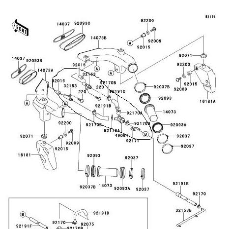

It will be from removing the clean air intakes in the ram tubes..
The ram tubes have a smaller rubber tube in them that goes to the carbs if these are removed the bike will run crap..
I know as I forgot to hook em up a few times and the result is as you have described...
The pic below shows the bits I'm talking about

i was just looking at that air digram and just wondering if anyone could tell me what the part 3213 is... its a connecting pipe from the rubber carb hose to the intakes at front...curious s to whether it helps pressurise or not.

you mean 32153? they are the little tubes that sit in the air intakes and take a sample of the air comming in and send it to the carbys.. when the bike is moving real fast the air in the ducts begins to build up pressure, and it needs a balance line to go into the carbys so that as airbox pressure increases, so does fuel pressure so that the fuel wont get pushed out of the carbys
im sure if you pulled off the intake trumpets and the balance line then the bike should perform exactly as it would on a dyno (130rwhp+) cept there would be no extra boost as speed increases
