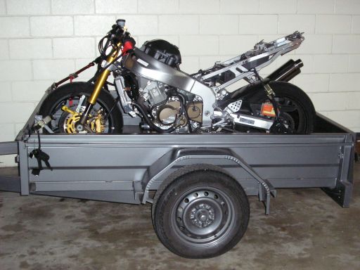

Yup
Dropped the bike off this morning.
Now i just have to wait..... :(

Damn i just got back from the frame straightener, both forks and fork legs are bent, triple clamps twisted, disks out by 40 thou, front axle bent at the end... :cry:
The frame hasn't even made it into the jig yet and the cost has doubled...
Most of this damage was wreaked by the guy i brought the bike off when he flipped it into a ditch...and its STILL the best handling bike I've ridden.
Makes me wonder how much better its going to be straight.
Reckon I'll put the trackie in once i get this one back.
