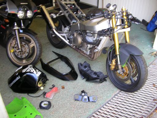

Well i went to dicksmiths today....no 0.125 watt 100 ohm resistors, try this 5 watt one...didn't work.
Called Jaycar, nope don't have any, referered me to RS Components (radioshack). Turned up, told em what i wanted, no worries 45cents for 10 pack.
Rushed home to fit one, didn't work...
Popped inspection plate off back of ign, resistor is different....took unit back to RS, oh thats a metal shielded precision 1% tolerance blah blah blah resistor. $15 for a 5 pack shipped from Sydney overnight, we'll call you in morning when they turn up.
Bloody hell i'm impatient, i wanted that bike running and all the rest of my parts on order by now.
