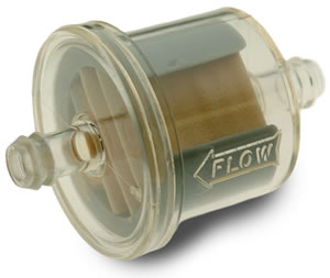

One that is external to the fuel tank as apposed to one integrated inside the tank. Mine is fitted between the petcock and the fuel pump, hidden just under the rear of the tank. I've no experience with internal ones on bikes, only ones in small engines. My Honda mowers have them, they are tiny screens fitted over the fuel outlet in the bottom of the tank. Useless they are.
fuel filter.jpg (29.49 KiB) Viewed 1892 times
