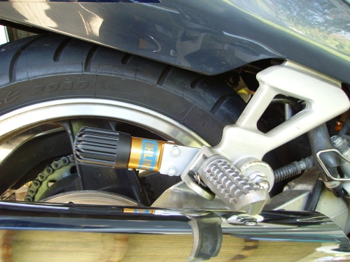

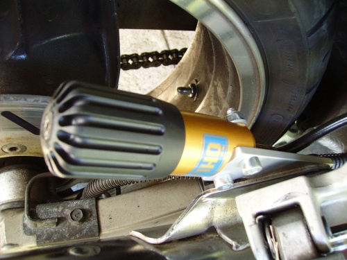

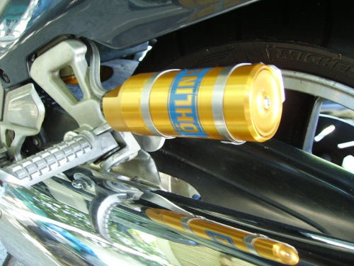

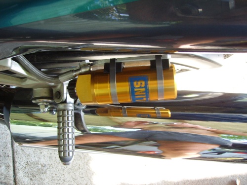

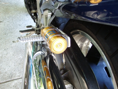

I dropped my bike off yesterday with, original shock, original F/end with original fork oil no doubt, and picked it up this arvo fitted with Wilbers springs and some valves up front and a juicy Ohlins rear shock complete with low-speed damping and remote preload for those days when the girl comes along. I had the fork seals replaced, one was dodgy, and while Steve had it stripped down the steering head bearings were replaced also as they were a little notchy after 49 000km. Now this was no cheap job, but it was done right I believe and a few behind the scenes things took place as well. He greased the linkages and found one loose, sussed it out and finding nothing wrong tightened it all up down there. The data sheet from Ohlins specified mounting the low-speed adjustment can under the side cover but a nice external spot was chosen and Steve knocked up a very professional bracket to mount it where it would be easier to reach, *and see* 8)

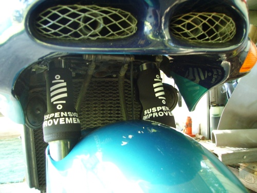

Fork protectors "with ads* were also a nice touch.
What a difference these upgrades made to my old ZZR11. I've only ridden about 50km on the new system but I sought out a few of the rougher roads and sweepers around where I live and the bike handled as though the road was smooth. :P :P :P :P Farking Amazing!! Feels like I'm on a 750, not some huge sport tourer. It's been adjusted for optimum performance at speed, on bumpy country roads and highways "which means MOST of the roads and highways" :x So it's a little firm around the backstreets he said, and I noticed. But it doesn't seem uncomfortable and certainly better than the *boing boing* I had previously with my compression damping on the 3rd or 4 settings. Hitting patchy roadworks and ripples hardly upsets it at all now, just a mild Bop Bop as you cross the rough stuff. Very competent.

Here are some snaps of the hardware
rebound can.jpg (103.06 KiB) Viewed 4246 times

so, when r ya comin' for a ride? And ya better hope ya girl doesn't kick the adjuster too hard when she's on ur back......:lol:

Yes, it needs to be moved up and in a little, it was one of the first things he pointed out to me. He realized that after he had made the bracket and fitted it, that it could have been in more. Trouble was he was working to a price and remaking it would have added a lot of extra time "he said". Actually there was no charge incorperated in fitting the rear shock. :) Fitment was a freebee if I got the front rebuilt at the same time. No doubt he made a little profit on the shock itself. :wink:

Frank I would be looking for a new home for that compression can once you are happy with the way its setup, I have mine clamped to the subfame well actually its on the floor at the moment i will get around to putting it back on the bike.
Firm without the banging is good and no wallow as well.
