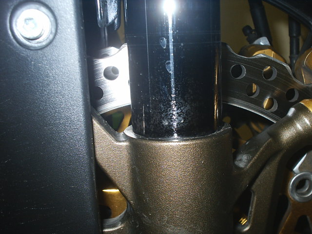

Hey folks
I can post pics due to dead camera, but has anyone heard of the black fork slider coating (DLC) coming off on the zx10r's? Folks i have spoken with have mentioned that some of the Suzooks had problems with the black coating scuffing and wearing off - but this was up at the slider end where friction played a role. My right fork is perfect, the left has the black crap dissapearing off the lowest inch of the fork slider area - not even in an area that sees slider travel. Currently waiting to hear back about this as a warranty claim, am jsut curious if anyone else has ever heard or seen it?

pics finally.. lol
Post by Afrodesia »
Ok, sorry this took so long.

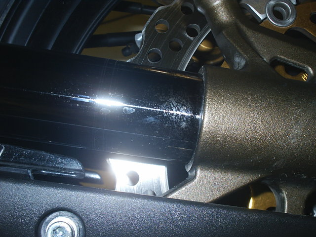

As you can see from the pic, the fault is below any area where friction could be the cause - last 25mm of the slider basically. U can see the rings above where travel has been stopping. It is like this all the way around the left leg (worse on the inside), yet the right leg is still perfect - so cleaning products cannot be blamed.
Bike only has 9000k on it.
looks like a warranty job to me...... :?

good news :)
Kawasaki Australia has approved the replacement of the lower fork leg - i got the expected "corrosion from cleaning products" question, but thankfully it is the left leg only. 3 week wait for part. Yay :)
