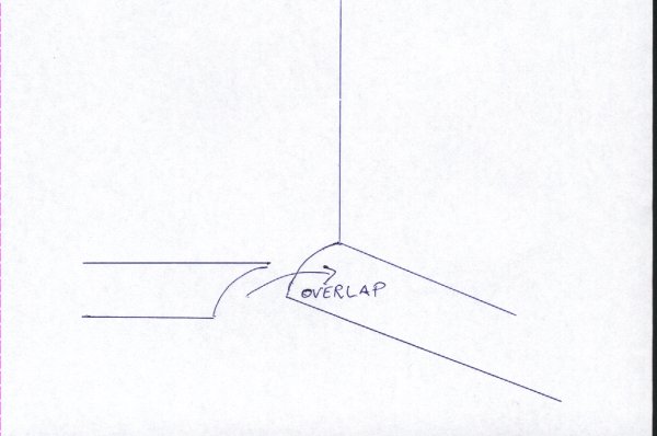

what you do is to lay one piece right into the corner ..with its end cut square (at 90° if you like) and use a jigsaw or similar to cut the quad profile out of end of the other piece (that comes into corner)
a perfect join (and one the trade uses which is where I learnt it )
not sure?
looks like this...'scuse the scribble
try it with a piece of offcut first
hth
Ian, that makes sense. And you didn't even use any confusing words like Gos!
The next question is, how the hell do I mark out the line that I need to cut? Given that the surface of the quad is curved...

To get the line of the curve all you do is do a 45 degree cut . The edge of the saw cut is then used as your line !
Buy a coping saw , very cheap like a hacksaw but shorter with a very thin wood blade that will curve around .

Jase
place the 2 pieces at 90° to each other and use the profile of the piece
(you are not wanting to cut) to do the outline for your pencil mark on the piece you will cut
hope that makes sense
then use a jigsaw or coping saw (as Bill said)
hth
