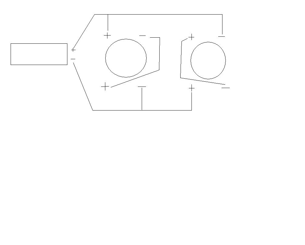

hey all,
just put a pair of 6 inch splits and a pair of 12 inch subs into my housemates car.
splits are powered by a pissy little amp that came with them (250 watts pmp) and the subs are powered by a 2 channel 400W amp (RMS) putting putting out 4ohms. the subs are dual voice coil, also 4ohms.
ive hooked them up to one channel of the amp using the following diagram.
the problem is they will cut in and out, basically being very temperamental. any hints on what i should do? oh the amp is bridgeable.

Connect them in series, the way you have them wired ATM has a resistance of 2 ohms, I am supprised the amp has not blown up!

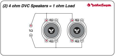

ok so why does it say 4ohm?
would this be better? cos it says 1 ohm

4 ohms divided X 2 voice coils is 2 ohms AC resistance not DC resistance you are reading off a multimeter, the reason the amp is cutting out is caused by the protection circuit, because the impedence is too low, hook them up in series, I.E + to (-)

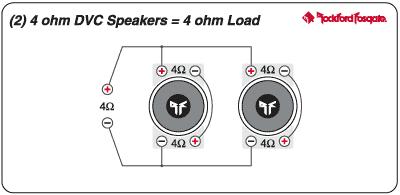

ok so i wired it according to the second diagram, i get constant noise but at a tiny volume. i can just feel the vibration of the subs.

mark, is the second diagram in correct?
or should it be like this?
