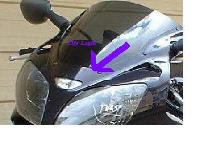

Hey guys, does anyone know how to change this bulb? I can't find it in my instruction manual...Do I have to take screen off and dashboard out, or does the assembly just pop put from the front?

I havn't sighted one exactly like yours, but the Japs are pretty clever and usually in 99% of cases it clips in from behind the light under the dash. Pull off the surrounding plastics for a better view. :)

Take the Screen out "Kinker" It's a rubber grommet press fit into the back of the lamp body, 5 min job mate.

daft question, but... city light?

mike-s wrote:daft question, but... city light?
Mike, It is the one in the middle.

This one here

Pontikat wrote:Take the Screen out "Kinker" It's a rubber grommet press fit into the back of the lamp body, 5 min job mate.
FIXED....Thanks!!!!!! :shock: :D
