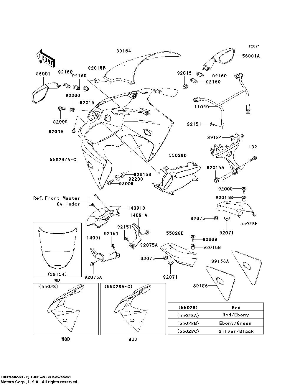

Have myself a nice 6 days off around my birthday in a few days, so decided (at midnight) to pull the fairings off and do a bit of cleaning. Most will be done tomorrow as I didnt want to upset the neighbours with the compressor going and its too bloody cold outside to be using the hose.
Anyway I decided to pull the fairings of the (99) zx6r to make it a quick start in the morning.
Well stuff my butt with a big stick and call me susan. Is there anything I didnt have to take off first before the farkin front fairing would come away. There are 2 bolts which attach to the headlight assembly that are nicely hidden behind the front vents. So to get at em the vents and resonators need to come out. Which finds me unsrewing everything I can see and still being unable to remove the bastards. Later I find 1 little screw hidden under a rubber flap where the vents meet the bike.
Now seriously its like a freakin jigsaw puzzle to get apart. Let alone puting it back together. Do they not think of these things when they assemble/design these things or have I been another victim of their evil japanese plan?
Any tips or re-assembling order would be great if anyone has stumbled across a trick or 2.

It's not so much the getting it together but more getting it apart and finding the right technique. Puting it together now (lunch :) ) Not having any problems thus far. I am looking at the number of bolts/screws I still have and am a bit worried. Im almost there.
Might have a few left overs :D weight reduction anyone ??
I do normally follow system 2 by puting the bolts back in the threads when I take them of but I wasnt originally planning on taking anything off other than the front fedner.
As for the manual . pffft have a look at the bastard
not much help
