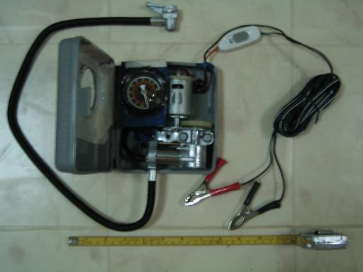

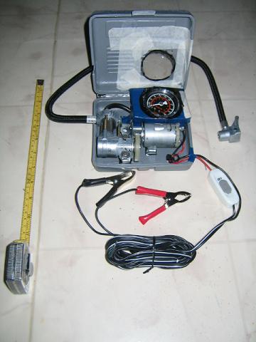

Got sick of using tire C02 cannisters for tire puncture repairs so decided to buy a second hand 12V/max 275psi emergency tire compressor kit which is bulky for S$10 and stripped the components out.
Fix,soldered switch and fabricated box to fit the compressor unit and it'll fill a flat 180 sized tire within 9mins to 36psi,just connect it to your bike battery with the engine idling and gone are the hassle of track day tire pressure changes to suit riding evironments and it is compact enough to fit into the C1 rear seat compartment.

looks like a lot to carry mate? I just stuff one of these under my seat, the motul ones are quite small now.

midorioni wrote:Got sick of using tire C02 cannisters for tire puncture repairs so decided to buy a second hand 12V/max 275psi emergency tire compressor kit which is bulky for S$10 and stripped the components out.
Fix,soldered switch and fabricated box to fit the compressor unit and it'll fill a flat 180 sized tire within 9mins to 36psi,just connect it to your bike battery with the engine idling and gone are the hassle of track day tire pressure changes to suit riding evironments and it is compact enough to fit into the C2 rear seat compartment.

Yup that works too but it messes with the wheel balancing.Used one of those before, have you seen the inside of the tire carcass when it's taken out of the rims and it causes some high speed juddering of the wheel. :)

Nice :D ... but do you actually have to carry the whole thing?
I used to carry around a $7 compressor from supercheap auto which is very small and fits under the seat. But even that was too big :lol: so nowadays I just bring a bicycle pump :lol: ... saved me in 3 occassions already on some dirt roads :D

javaman wrote:Nice :D ... but do you actually have to carry the whole thing?
Yup Javaman, it'll fit nicely into my C1 rear seat compartment with the rest of the tools i've got.
Cause when i installed the undertray unit, i also made a box cage to hold tools etc and there was more room so i took the dimensions and looked for a box to hold the pump unit :)
It'll come in handy on the next trip to somewhere i reckon.

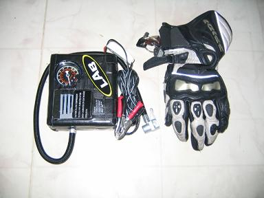

Here's the finished product .
