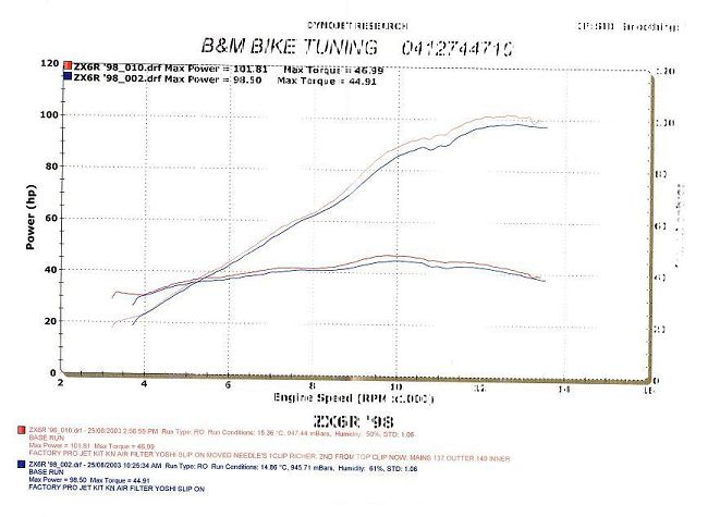

That's an oolld post, from when I was living in Rocky. I've been to Axles and ended up with 102.swabio-ACT wrote:mate.... I know there is at least one dyno in canberra.... @ RObbo's and I think Axle's has one also..... ***paging gos....Aussie Ninja wrote:Nice one. I know it costs money but you need to get her back on a dyno to get it exactly right. Not that I can talk 'cause I haven't, but I'm sticking with the excuse that the nearest one is currently 7 hours away.

I'd just go for the factory pro advancer. I talked to Marc about them and he told me that +4 is as much as you can go without over advancing the top end. Plus it's not like you can pop the hood and change the timing you've got to take an engine plate off, which has a gasket that will probably tear. My scoot has a full yoshi, Factory jet kit and +4 advancer and works a treat. I've only got my bum dyno for the comparison to my bike stock, but I think 9 or 10 ponies isn't out of the question.
