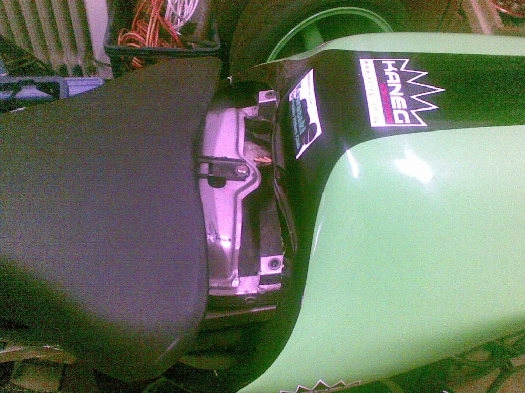

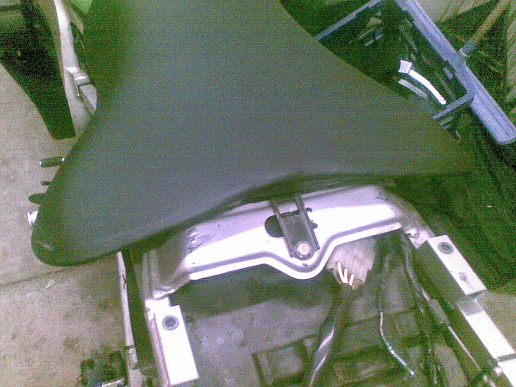

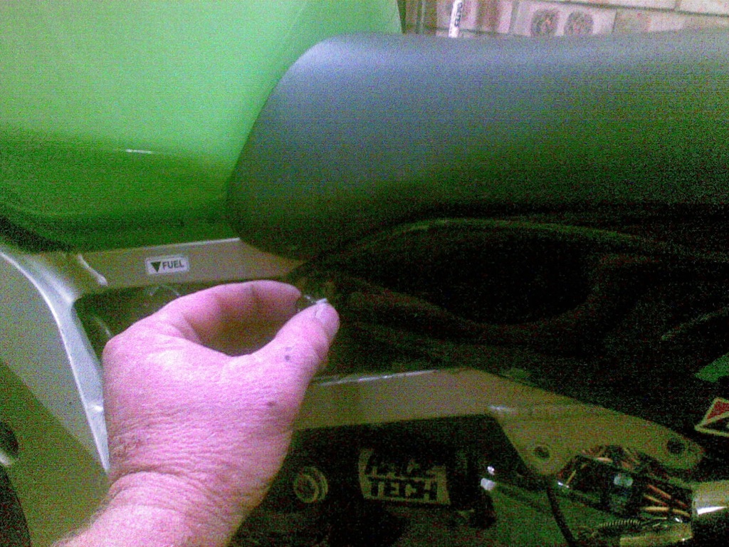

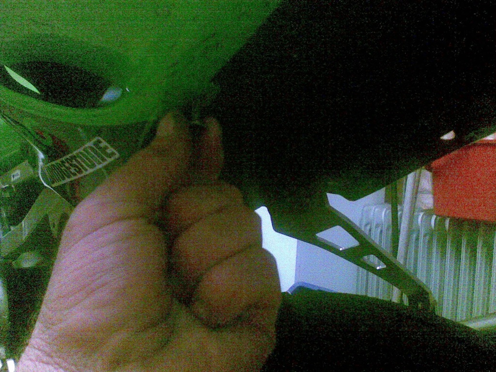

here you go mate,,,,,, step 1\before putting the tail on ,bolt the seat down/pic 1,,,,,,,,step 2\now slide the tail on /pic 2,,,,,,,,,step 3\line the screw holes up and tighten/pic 3&4,,,,,,and there you have it ;) :D
