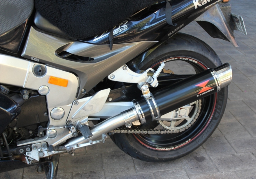

New silencers (Black Widows) are excellent, very nice sound. I have left the dbKillers in, but I chopped off the end caps. It is just too loud with them out.
