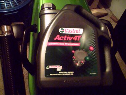

why 3000 k's?
call me particular, well the standard service intervals are 6000 k's, and I like to change the oil between these 6000 k intervals, so 3000 k intervals are evenly spread between services.
I could proly leave it to 6000k's, but I love new oil, it makes me feel good.
also, I only use Mineral based ? oil. It's about $25 - $30.
it's also easier to change oil on a naked bike, 20 mins max. I wouldn't rip fairings off to do it.
Btw: I've heard it is a bad idea to swith back to mineral oil once you have had synthetic oil through your engine.
