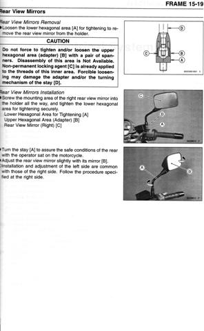

on my er6-n the mirrors start turning in once I get a bit of speed up and I have to keep pushing it back.
its not coming loose at the screw (the other side did that and loctite worked) but in the adjustable bit
on the stem. any idea how I tighten it?

G'day - hope this helps
- IMG (Small).jpg (23.39 KiB) Viewed 1630 times

Re: farken mirrors
I have the same problem on the zeddy with the original mirrors... I just wind them clockwise till they are tight... but anything over $140 and they flap around again, at the moment I dont care because they are going to be replaced with bar end onesdilligaf wrote:on my er6-n the mirrors start turning in once I get a bit of speed up and I have to keep pushing it back.
