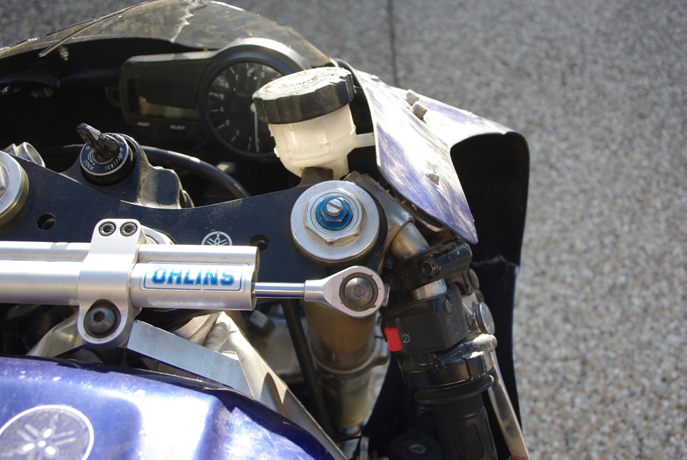

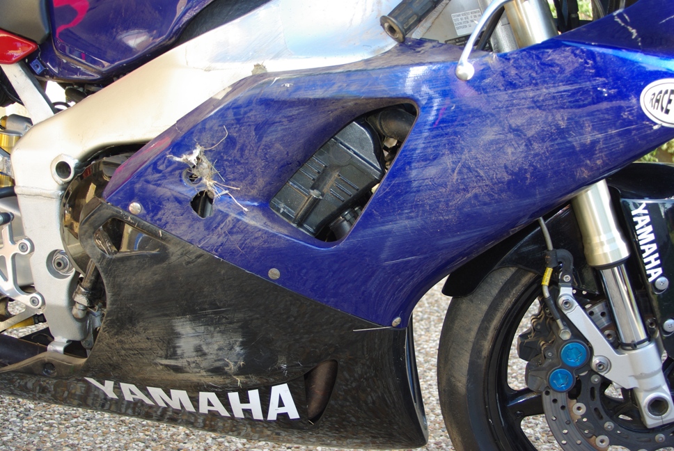

After my off on the R1 (pic of the damage below) I've put a new handlebar on and hooked everything back up but now the throttle does not snap shut but it does close by itself by veeeery slowly and therefore I assume it won't pass scrutineering.
Could I have kinked the cable when the handlebar bent? Any thoughts on a solution, I don't really want to remove the cables, but I may have to

Firstly make sure the inside of the throttle tube is not chaffed. It could be catching on the new bar. If that's OK, then I would check for a bent cable sleeve to see if it is binding there.
the grip hasn't stretched over the end of the throttle tube has it???

The grip isn't stretched over the end of the bar as the grip has actually got a hole in the end of it
, new one ordered
Cable still has the same amount of slack in it as before, the whole action just seems tight/less free than before

Perhaps I havn't made myself clear. What I was eluding too, was that the rubber grip might be hanging over the end of the throttle tube and catching on the handlebar tube...not over the end of the bar.bishboy wrote:The grip isn't stretched over the end of the bar as the grip has actually got a hole in the end of it, new one ordered

I think we've got crossed wires here. I understood you to mean that, but the rubber grip has got a hole in the end and the handlebar tube sticks out the end of the throttle tube, as per picture.Perhaps I havn't made myself clear. What I was eluding too, was that the rubber grip might be hanging over the end of the throttle tube and catching on the handlebar tube...not over the end of the bar. Next time you ask for help, maybe i'll just shut up!
One other thing I've just thought of is that I got the handlebar tubes are very slightly bigger diameter than the original and the throttle tube could be a bit tight and therefore grabbing, but from memory it seemed quite loose, have to have a look when I get home.

Yes you are right it does stick out the end just like ALL throttle grips should!!!!!! I was speaking of the last few mm's of grip, binding on the bar. Now that you have posted a pic, I can probably guess at what has happened and what's causing it to bind.
