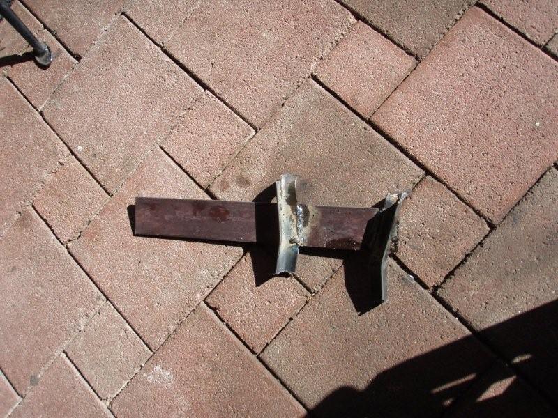

Re: Input shaft nut removal
Both times I've done it I've had to make up a tool to hold the clutch basket. It doesn't have to be complicated but you do need to be able to get to the nut once the tool is in place. Here's the one I made for the z650 recently, the long piece locked on the rear brake pivot which meant I could get heaps of leverage on the nut without stuffing the gearbox at all.
