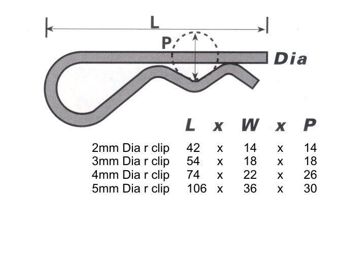

Re: chain adjustment: cotter pin?
Use an R Clip......... then you wont have to replace it again.
Any bearing place will have them + some bike stores & accessories stores
- r_clip_details.jpg (42.6 KiB) Viewed 3980 times

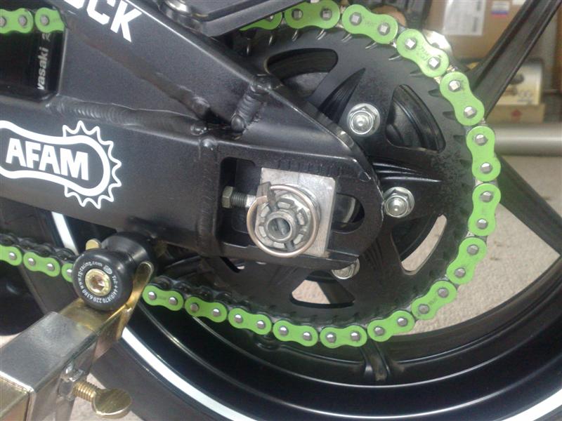

Here is a pic of mine
- 22032009335 (Medium).JPG (96.63 KiB) Viewed 3886 times

- ZX-10R_04
- Posts: 762
- Joined: Wed Aug 11, 2004 11:18 pm
- State: Tasmania
- Location: Launceston Tasmania
Yeah much easier than the R type clip & no hassles of the clip stretching out over time of use or half hanging out sideways
I used a lynch pin on my old 97 ZX6R also & was one of the 1st things i done to my ZX10R after i purchased it 6 years ago seems they make wheel adjustments or changes way easier
