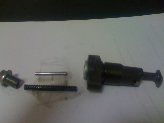

Rob I changed one the other week on a little newer zx6....Is a peice of piss to do...They are a spring loaded ratchet and they do tend to fail apparently....In my case it was the spring that hold's the ratchet locked in if that makes sense
....It was deformed and the lock wouldn't lock if that makes sense
There is a trick apparently the tension spring can fail and you can pull it out and stretch it and reload (didn't work in my case)....If you like I can take a pic of the one I took out so you can see what your dealing with.....

Here is the one I took out...you can sort of just see in the pic the small spring on the locking mechanism has deformed and popped out a bit causing it not to lock properly....The larger one is the one you stretch for more preload for lack of another word
- photo(4).JPG (45.83 KiB) Viewed 4083 times

Don't have any problems with doing it Dave, I have done automatic ones ones on older bikes including manual racing tensioners but this could be a hassle as the everything has gotta come off including throttle bodies to get to it according to the manual, once again I can do it but with the SV on the bench in a million pieces I really don't want to start another teardown.... not that I have the time at the moment anyway work is murder at the moment.... you know the feeling
Disco wrote:Rob I changed one the other week on a little newer zx6....Is a peice of piss to do...They are a spring loaded ratchet and they do tend to fail apparently....In my case it was the spring that hold's the ratchet locked in if that makes sense....It was deformed and the lock wouldn't lock if that makes sense

I have no doubt about you mechanical capabilities
Mine was on the right hand side and only a fairing off job....As you stated yours sound's like a bigger PITA
