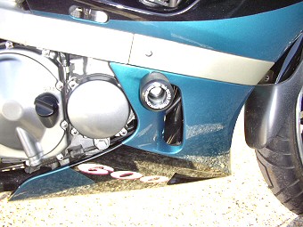

Can you (or anyone else) tell me the torque settings for the 2 side engine bolts (left and right) that are behind the lower fairing as in the attached pic please?
I've decided I'm just going to suck it up and drill the fairing to fit the crash knobs I got months ago - I want to fit them before I head to the track in 2 weeks.

ZZR600 Engine Bolt Torque settings
- zzr6oggy.jpg (46.73 KiB) Viewed 5920 times

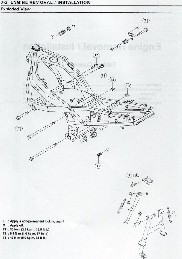

This any help?
Mick
Mick
- enginebolts.jpg (108.11 KiB) Viewed 5893 times
- enginebolts2.jpg (18.86 KiB) Viewed 5892 times

Thanks Mick,
I also got a call from Colette (and Steve) last night to help out.
Looks like it's 36ft-lbs, but I'll need to check what the bolt actually looks like. I think it's that T3 bolt on your pic which also say 36ft-lbs - so that's a good sign.
Thanks to Colette, Steve and Mick - I'll be drilling the baby this weekend
