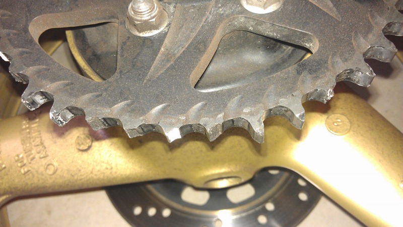

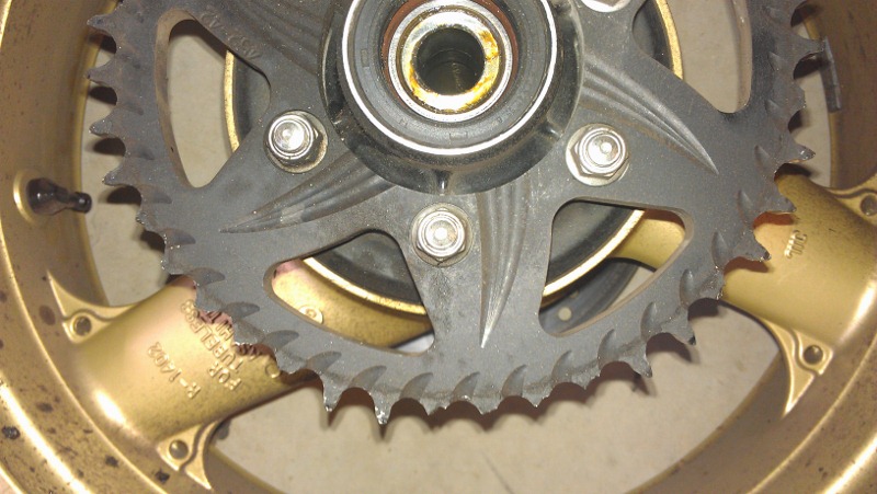

We went for a quick ride today and a couple of times the chain slipped, once when I went to clutch it up and then again when I tried to take off in first gear. I didn't think much of it and assumed it must just be a bit loose. When I got home and went to tighten it, I noticed it was a bit hillbilly and was missing a few teeth.
Sadly, I had thrown my OEM one away when I put the new chain and sprockets on so I had to order a new one. This time I opted for a steel one instead of alloy as I don't think the alloy can handle all of the wheelies that the ZRX makes me do.

- IMAG0199 (800x451).jpg (151.89 KiB) Viewed 8143 times
- IMAG0200 (800x451).jpg (147.94 KiB) Viewed 8143 times

Holy crap!! How long was it on there? That's def munted lol

I reckon probably about 10,000km Tim.timmyrocks wrote:Holy crap!! How long was it on there? That's def munted lol
It's -1 on the front, full system pods and stage 3 jets, heavy duty clutch with a quick action throttle and it cops a few too many clutch up wheelies and has to lug my big arse around, so I'm not too fazed about destroying an alloy sprocket. I'll just stick to steel ones from now on.

Looks like a Vortex sprocket. Warranty? Probably fuggered your chain in the process too.

Nice work!!! Send the photos to the supplier hehe

It is a Vortex sprocket. I don't know how I would go with a warranty claim with the abuse that it cops.bonester wrote:Looks like a Vortex sprocket. Warranty? Probably fuggered your chain in the process too.

Alloy vortex's will do that, seen it happen on bikes lot lighter than that too, like a 636...
